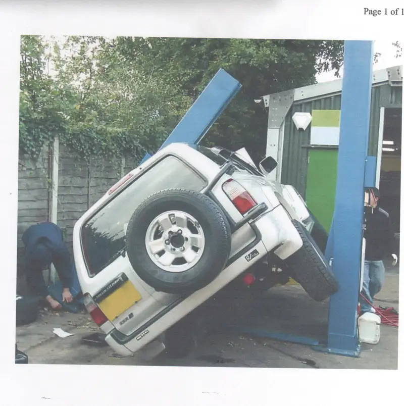

It is surprising how many accidents occur during the use of automotive lifts. I worked for a large retailer which had several
hundred auto repair centers. In theory, employees there had been adequately and appropriately trained, many were highly experienced. The incidents I heard of, and several which I saw, were beyond belief. One of the worst I recall was one of the older, subsequently removed, hydraulic lifts having a single large hydraulic cylinder mounted in the basement below the shop. A 1-ton Ford van toppled off from top height, the safety column having been in place. One of the vehicle support channels up front broke off the hoist. Fortunately, no one was beneath the van at the time.
Please understand, I am not disagreeing with your contention. Many individuals working under vehicles undoubtedly should not be doing so. I suspect the collapse shown below was indeed caused by faulty mounting or concrete support, or both. I tried a search for accident data stats but came away with none. imp
