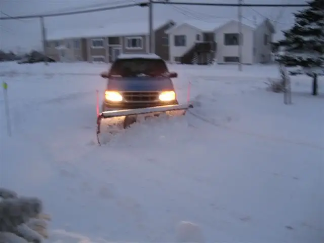

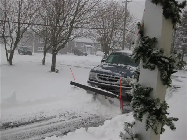

My dad has had this plow on a 91 and this 96
The 96 has been fine, the 91 did require a transmission replacement one winter.
No need to plow in 4Low, it would take you forever.
Dad's does not have downforce, (its about 20 yrs old) but I think most of the newer ones do, that would be a good feature for a clean surface.
Power angle is a must
For the past 5 years, I was plowing with a 1991 Explorer 2 door with Fisher 6'6" MM2... It was great. That beast finally died 350K miles in! (Tranny quit & opened up on the roadway and spilled the most rank fluids I ever smelled... but thats another story....)
I have researched the plow I want extensively.... Having plowed for over 10 years and used a dozen or so commercial and personal setups... I am buying the SnoWay 22 series (330 LBS all in) with down pressure...
