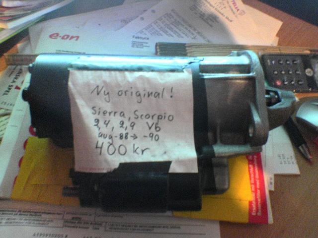

I found this starter motor that is new, original and fits Ford Scorpio and Sierra. Dunno if these models ever was sold in the US.
Ad says it fits to SIERRA and SCORPIO V6 2,4 2,9 88-90
It looks the same as the one that goes to the explorer 1st gen (1993) but is it the same?
Anyone know a part# for the explorer dito?

just go to the parts store and buy a new lifetime warranty one....
The thing was that this was fourth of the price of a new one. And the seller claims that it is new.
Get the part from the seller, and go to the manuf web site and see if the part number is the same as your application. You could accomplish the same thing by going to autozone.com and look up a starter for both applications and see if the part # is the same. I suspect they will be different.
I tried to do that. As I understood Ford Sierra or Scorpio is not sold in US and the 1st gen Ex was never sold in my country. Therefore it is hard to cross check..;)
Tried also to call Bosch since I had the US part # of the starter motor ( got it from rockauto's page) . They replied that it was impossible to find out since US part # and European part # did not match. And that was it. Pretty strange if you asking me... Same same but different... But there is big differences in the US market and european. even within the companies.
Anyway, last option was a brand new aftermarket, 1/3 price (approx. $187) of a ford starter, I'll go for that one...
