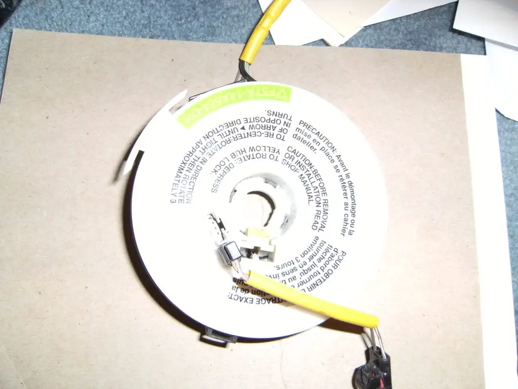

Could be the clockspring..

i'd say clock spring

OK I am new here so what is clock spring and why would it make my horn not work either ? :dunno::dunno:
Clockspring is the ribbon that connects all of the steering wheels controls (stereo, climate, cruise, horn) and the airbag, you might want to do a search for clockspring and read through whatever you find, then if you still have a specific question it will be easier for someone to help you

The clockspring is under the steering wheel. You can replace it yourself if you have some torx bits to get the wheel off. Don't need a puller- I've bopped them with my hand (alternating the location of bopping on the rear of the wheel) to work them loose and off at the junkyards for years.
