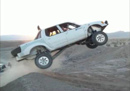

Here's a modified 2nd Gen Sport Trac. It's built for desert racing. Looks like he replaced the front suspension with a coilover suspension.
http://www.daveturnermotorsports.com/index.html
The picture below is from Dave Turner's profile on www.mysporttrac.com
