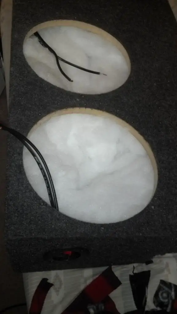

The poly-fill tricks the subs into thinking there is more space inside the enclosure, I believe there is a chart somewhere telling you how much poly-fill it will take to make the box seem that much larger to the subs. find the perfect sealed enclosure space for your subs, and match that, then you will get the best amount of bass for the space.
quick Google search brought up this from another forum. "General rule of thumb is about one pound (16 oz.) of poly fiber fill per cubic foot. "
Doing more research that's what I found. Well the box is stuffed and sealed, I'll let ya know how it goes!
I had a stuffed and sealed box for a single ten and it was louder than my dual box for 10's without the polyfill. if that means anything...
Absolutely- need the polyfill.
If you need more, I filled mine with batting material (for stuffing pillows and quilts from the craft store) for about $2 per bag. Works awesome!
I got the prescribed amount for my box! Just need to dynamat behind it and its gunna rock!
