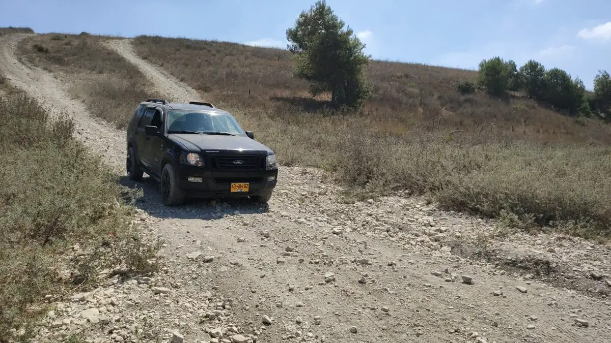

Hi all
Since in Israel the only legal option is 1"-2" range spacers with stock struts only im looking for suspension lift optimal solution on my 2007 EX.
No control arms change allowed too in my case.
Is the 1.75 front and 1.25 rear spacers are suitable without any major driving experience(i mean some bad aspects)?
What the maximum spacer heights can i use without any extreme damage to balljoints or driving in general.
**using stock 17" size KMC Rockstar rims.
Now my current ride height is very low in basic offroad terms.
Tnx all.
