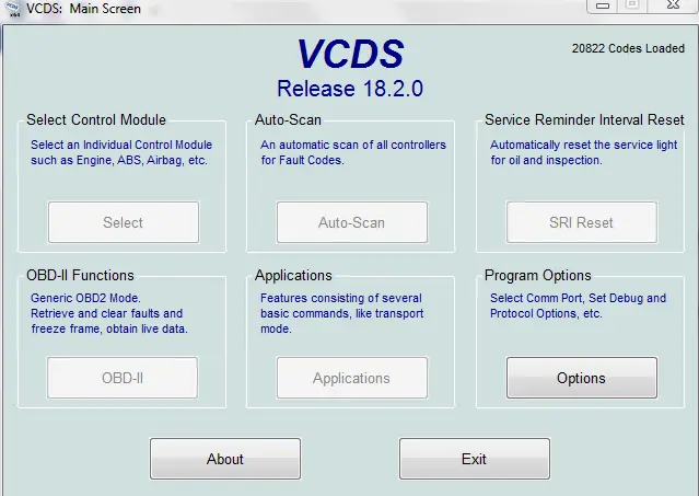

I currently use VCDS for my Diesel Jetta and Audi TT maintenance and to keep them both running.
Does anyone use a system analysis tool like the VCDS for troubleshooting the Ford Explorers and what is the name of it? Cost?
