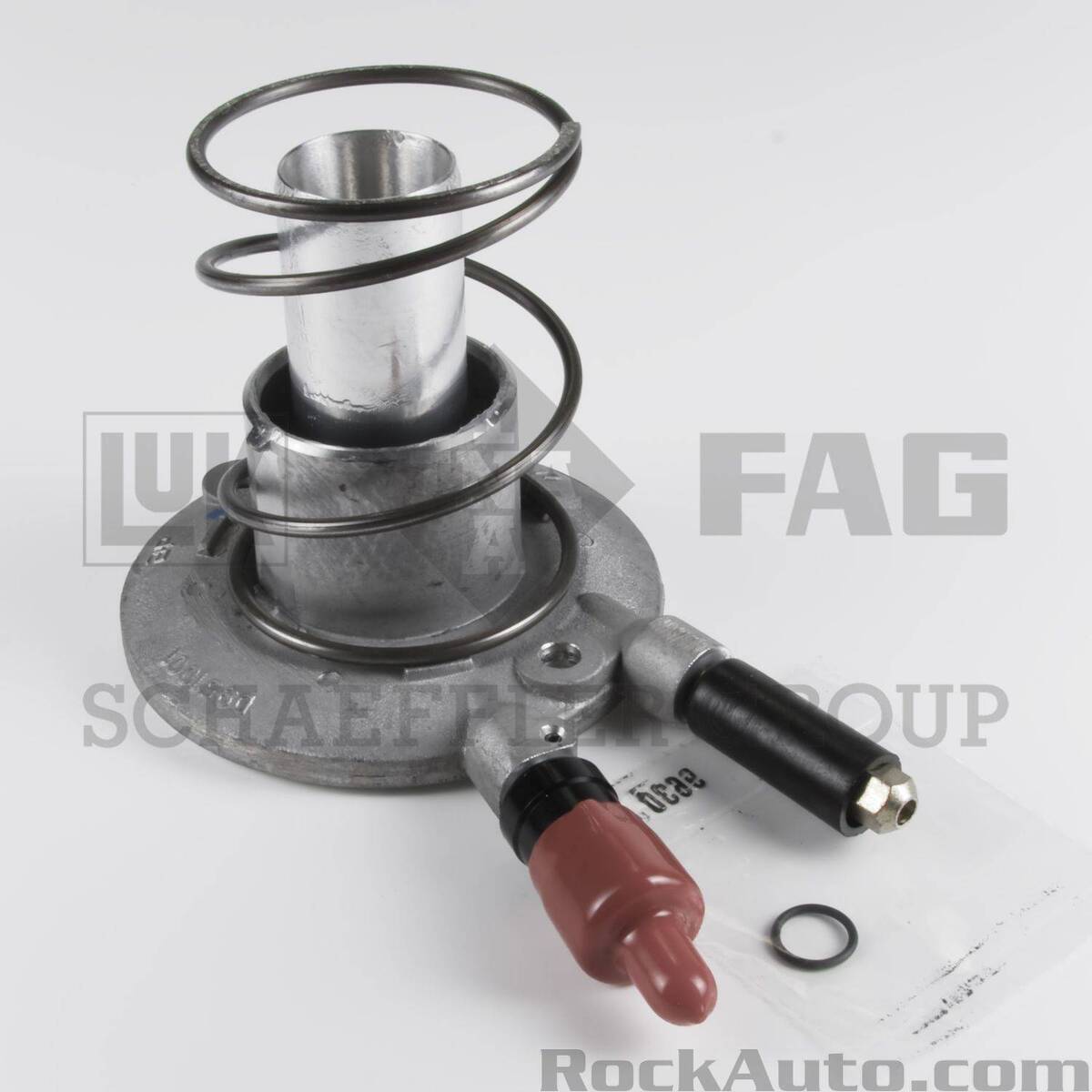

I need one last thing from you guys. Will you please take a look at the video I am going to link. When I got the trans out the clutch looks great to my eyes. It looks shinny and new, and everything seems ok. The slave on the other hand was destroyed... It was leaking so bad that the clutch did have some grease and liquid on it, is that ok? Please watch this and ask me for anymore details.
If it is just the slave I need to replace should I put in a cheap part again? Or should I really roll the dice and buy a 200 dollar slave. Is this link the correct one?
http://www.ebay.com/itm/BRAND-NEW-G...7268&clkid=2755295655349042964&_qi=RTM2247627
If you have a link to a Ford slave, or motorcraft? Let me know.

You're considering $200 for just the slave cylinder on a 25 year-old commuter vehicle? The Links that I provided in your first post to RockAuto totaled around $200 for the parts. Do not equate higher price with higher quality, especially when LUK parts are OEM ford in some cases. $36 for a LUK part is great, when you consider that the $200 Ford part is probably just the same LUK part with a Ford logo stamped on it. The one that I pulled out of my ranger was like this.
The parts that fell off the front are just the release bearing and return spring. The piston that moves the release bearing forward is the slave cylinder, and they aren't necessarily going to be attached.
Picture of new LUK slave, without the release bearing (which is included in the LUK kit). I promise I'm not trying to sell LUK parts, I just had a good experience with them on my ranger, and noticed that all the parts I took off were LUK parts with the Ford logo on them.
