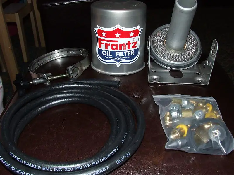

She is a beauty!!!!! Cant wait to install her.
I am currently running a Perma Cool Dual remote setup. I have a bypass Filter (B50) and a full flow installed. The perma cool dual remote setup does not have the restrictor valve in it (Amsoil dual setup does) which helps make some backpressure to flow a bypass spin on effectively. I was not sure how effectively my bypass spin on was filtering. It does get hot just after the full flow. The baldwin B50 is rated for 5microns, but I wanted to get the best filtration as possible. So I decided to go ahead and buy the Frantz Bypass setup. You can find them on ebay as just a filter purchase, but your gonna need lines and fittings. You will most likely end up back at Frantz web site purchasing them. This is a new up to date kit and came with everything for the install. It also cam with the punch and self tapping hollow bolt, so I can return filtered oil to the pan.
What I will do is from a spare port feed my frantz bypass filter and a mechanical pressure oil guage. Then I will remove the B50 bypass spin on and re-install the 3/4 16 nipple back into my perma cool dual remote unit. I then can run 2 full flow B2 filters with 8-11lb bypass valves (wix 51515).
This is a complete kit and NOTHING extra is needed to be bought.
Will take pictures as I set it up. That should occur this saturday..or later today I should say..lol

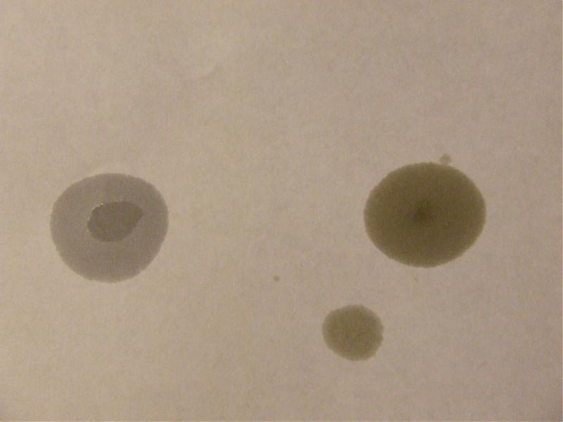

I installed this setup at 73434 miles. I installed 2 Pure One PL30001 into my Perma Cool Dual remote setup. I took out the bypass threaded nipple and reinstalled the 3/4 16 threaded nippled back in. I filled up with about 8 quarts of Pennzoil Platinum 5W30. I have just over 74500 miles now (1066 miles on filters) and the oil is looking very good. Looks like the TP filter is doing a excellent job. I will be sending in a sample for analysis at the 2k mile mark.
On the left is Virgin PP 5w30 and the right after 1066 miles. An analysis will tell me if my nice looking oil has any wear issues floating around in it, but for now this looks pretty good.
