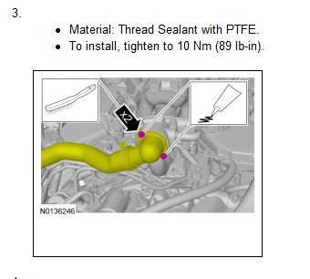

Thank you very much! I didn’t see any sealant on the bolts when I took them out. Probably would hurt to put a little on them though.
The housing bolts do not contact the coolant at all so there is no need to seal them!
