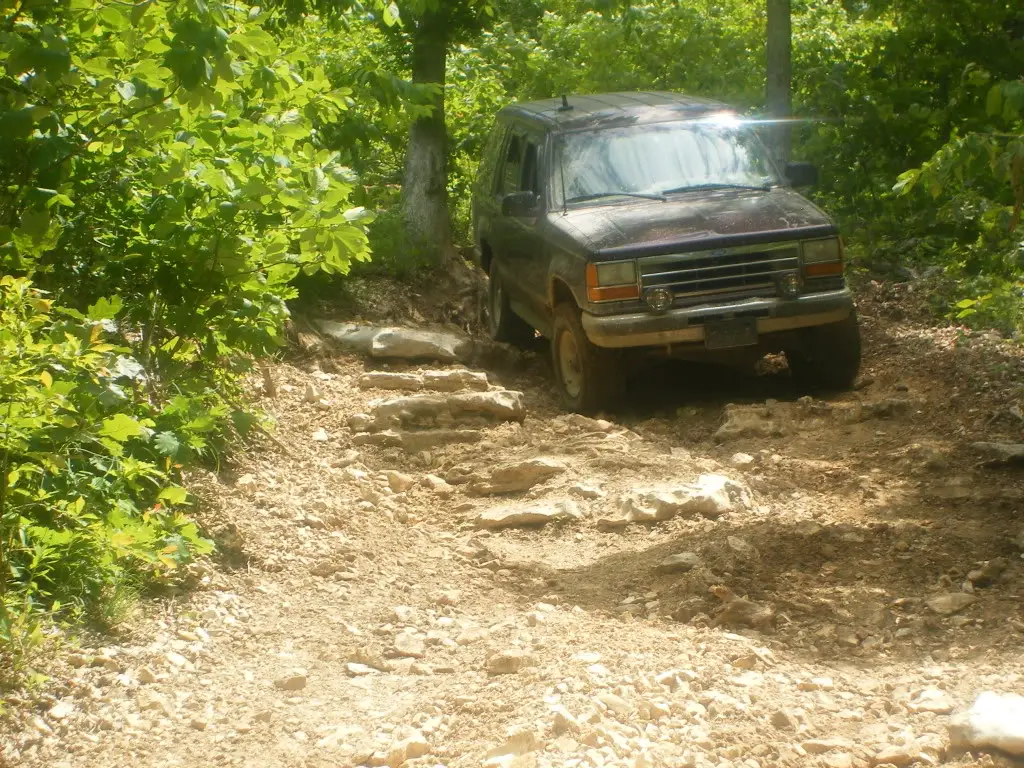

94 Ex XLT
2" lift on 31"x 10.5" swaybars disconnected, stock everything else!
It got wheeled on level 2, & 3 rated trails and it did great.
