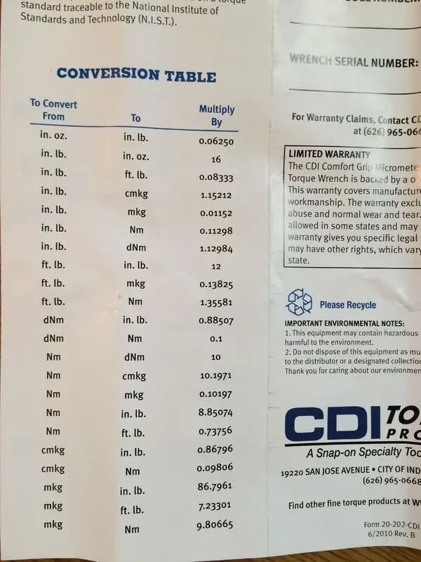

Over the years I have seen this come up a few times and thought I would share this with others.
Interesting. I had no idea there were so many different kinds. I always did inch pounds to foot pounds. Going to save this for later. Thanks for sharing.
If you have a computer in the garage, you can use google too..
For example, search for "convert 10 inch ounces to inch pounds" and it will tell you it is .625 inch pounds, right before the search results.

Course, I'm still going to print and hang that pic in the orig. post since I don't need to touch anything to read that.
~Mark
I can give you a large hi-res copy if any one wants one. PM me anytime.
You are quite welcome. The least I can do for all the help I received.

Printing this out would be a great idea. Another neat thing to have on the wall :)
