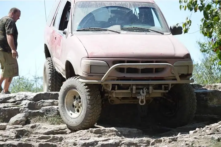

I use and would highly recommend a front reciever with a Warn reciever D ring as a tow point. It does fit with a stock bumper, at least it did on my '96. I have been wheeling this setup hard for 5 years and never had an issue.
