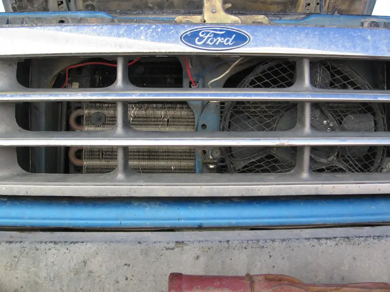

I have the fan in front of a cooler (I actually have 2 coolers, one in front of the other)

Now that is about the exact setup I was looking for. Did you get rid of the AC condinser or did your truck not come with AC?
I actually have a smallish plate cooler in front of the tube/fin cooler in front of the a/c condensor in front of the radiator....
I am going to change it soon.. I'm going to take out the tube/fin style cooler and put in a bigger plate cooler. The plate cooler will be at least 5" taller so all of the fan will be over the cooler. this will leave 1/2 of the radiator/condensor more clear than it is now. (I "might" put an aux cooler in front of them, but I'll start w/out it). Plate coolers work better than tube/fin so I figure a big plate will work better than a plate+tube/fin especially since putting coolers behind others cuts their efficiency(sp?)
As I have it now, if I let the truck idle too long with the a/c on it will get very hot.. (not overheat, but much hotter than I like.. 195F is between the R and M on the guage and it will go up to the A/L when idling.
Keep in mind, I'm in southern Az, so it gets hot here (It was 107F or so yesterday).
~Mark

I use the factory belt driven fan for main cooling and the single 10" fan for the trans coolers.
The belt driven fan has a tight fan clutch (its for an RV application). I hear the fan more than the engine most of the time when I'm dirving around town.
The electric (trans cooler fan) runs whenever the transmission is not in lockup mode. That means in general, its not running at speeds over 45mph.
The pan temp seems to average 70 degrees above ambient temp on the freeway and 80 degrees above ambient temp around town (85 degrees above ambient in really bad stop/start traffic).
Remember, I have a 700r4 transmission with a somewhat high stall converter (it stalls around 2700 rpms) which doesn't help my temps.. But the fan did make a big difference in my trans temps around town (seems to be a bigger change than adding the 2nd cooler, which I did before I got the fan).
In the Arizona heat, my trans fluid pan temp seems to run between 160-185 or so in summer. Every few oil changes I drop the fluid in the pan and replace it. I change the filter about once every 6-9 months (when I feel like it but at least once a year). The fluid has always come out bright red and with no burnt smell. I use mobile 1 synthetic trans fluid and have about 60k or so miles on this transmission (I think thats just over 2 years, I'd have to look at when I got the transmission installed).
~Mark
