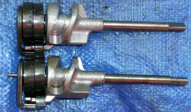

If you just want to get the truck home:
1) Park the vehicle on a solid flat ground.
2) Put two bricks in front and behind one of the tires - leave a few inches between the brick and the tire and put the transmission in Neutral. The vehicle should not move but you should be able to push the vehicle back and forth a few inches until the tire hit the bricks.
3) Remove the shift motor (zip tie it to something else, like the frame rail) and under the shift motor, you will see the shift rail. The shift rail is triangular. Around the shift rail will be a stamping on the transfer case itself that looks like a clock. On one end it will say "4L" and on the other end it will say "2H" (or something similar).
4) With a pair of (short nosed) pliers, rotate the shift rail until it engages "2H". You may have to move the vehicle back and forth a little bit in order to engage "2H" so it helps to have another person around doing the pushing while you try to rotate the shift rail.
Note that the shift rail has a clock spring and will try to snap back if it can not engage "2H" properly. So if its not engaging, rock the vehicle back and forth.
This is the shift rail you'll be working with (there are two in the pic). The end on the right is what you will see once you remove the shift motor.
