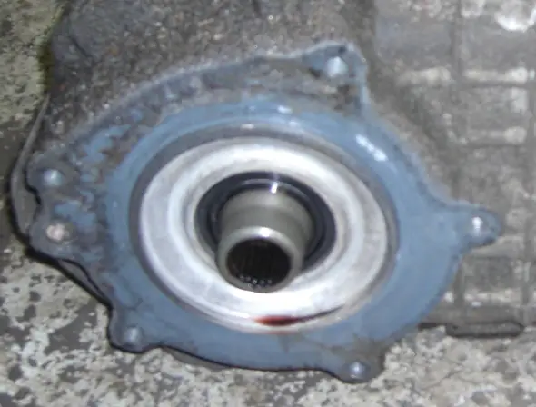

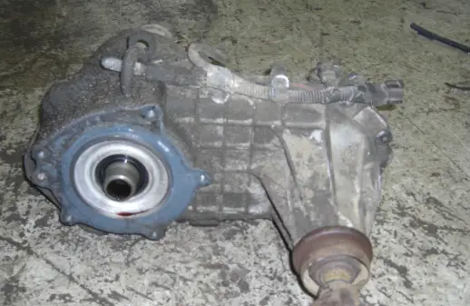

first i undid the back driveshaft from the pinion,12 mm socket , and than i undid the front driveshaft from that pinion, 10mm socket , than i undid all the t-case mounting bolts on the front between the trans and the t-case, all 13 mm bolts,, the top ones were hard to get , so i dropped the one side of the trans crossmember to make it a whole bunch easier to get it out,, ,
once all the bolts were out i pulled back the t-case a bit to get the slip yoke apart , and slid the t-case back to unhook the wiring, and than out onto the floor,, i couldn't get the front driveshaft out, so i left it in at this point,,
next i had already separated the new t-case from the new trans i got and moved it near the van , it still had the front driveshaft hooked up to it as well, seems to be a common problem, i couldn't get it out either,,
next item was to slide the new t-case under the van on a jack , than i fed the driveshaft up over the trans croossmember, and up to the front pinion,, , as i had a friend slide the jack in and lift it up , i got a few of the front pinion bolts on first , as i slid the yokes together inside the transmission ,
i than put a few of the bolts back in the front of the t-case to hold it in place,, and hooked up the wiring,, , just 1 plug, after all them bolts were tight , i took out the plug on the back side by the rear driveshaft output ,and filled it till it was coming back out a bit,, that means it's full, ,
than i put the front of the back driveshaft back into the reap output of the trans , and than put the driveshaft up to the pinion and started the bolts,,
i went back to the front driveshaft and made sure all the bolts were tightened properly, and than checked all the t-case bolts,and reafastened the crossmeber bolt as i jacked it up , than i finished up with making sure i tightened all the rear pinion bolts,, ,
after i tightened all the rear pinion bolts i jacked up each end and took it off the stands , and back on the floor,, , after i did this , i took it for a test drive , it worked great ,
during the test drive i went around a corner and heard a funny noise,, so, i stopped and let it idle,, no more noise,, hmm, , i turned the wheel and went ahead a little bit,, alerting me to another problem , , worn out cv joint in the front on the passenger side,, that will be another day,, i parked it and had a smoke,, happy , but not finished yet , , ,

There are only 5 bolts(1/2 inch) on the front of the t-case. They are seen in the pic in the front of the case. Most are pretty easy to get to except for one. The top one on the left side is right near the cat, so that is why I dropped the crossmember to get that one out.
Another thing is the fluid. It is filled with atf, and not gear oil, so I used Mercon V. It goes in a big bolt like plug on the back right by the output for the rear driveshaft. It is a 1 inch bolt.
