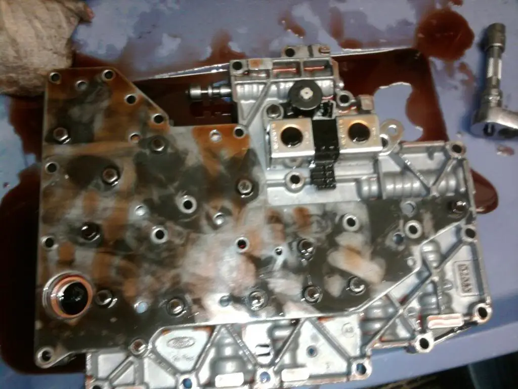

So I removed the valve body and didn't see any big gasket blowouts. There were some splits but nothing blown out.
Also there was some sludgy black material coating the magnet and coating the valve body in some areas. This is clutch material Im guessing, but was it more than normal for 110K miles? There wasn't enough to coat the bottom of the pan but was still present.
Im wondering if I should put the new gaskets in with the new filter and fluid to test it out or just call this tranny shot?

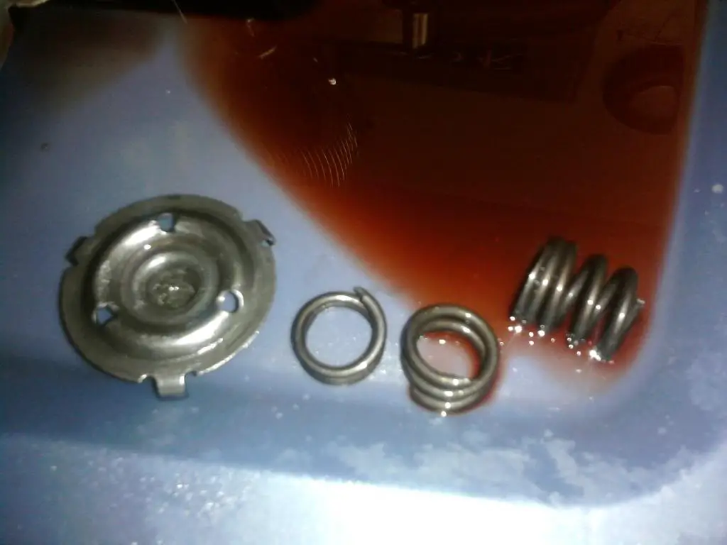

So I figured out what the problem initially was. I had a broken 2-3 accumulator spring. I read in another forum on another site that having this can eventually cause the clutches to fail. :frustrate
Its only been going on for 3 days, but still, on the third day 3rd gear went out completely where as I wasn't able to shift past 2nd.
Can having a busted 2-3 spring cause 3rd to go out like this?
The sludgy material that was on the pan magnet was about half the volume as the magnet itself. Also the film on the VB plate shows how much was present there. Does this look like the result of a burnt clutch?
I don't want to waste the fluid and gaskets if a rebuild is needed, using twice the amount.

Im elated to report that I fixed the transmission problem by replacing the 2-3 accumulator spring!
I though for sure the clutches were toast but after putting in the new spring and changing all the VB gaskets, new filter and fluid she shifts fine. :D
For all those experiencing similar problems, CHECK YOUR ACCUMULATOR SPRINGS before having it rebuilt!
