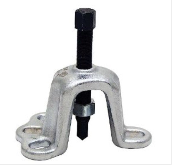

The axle has slip room within its joint. Allows the wheel to go up and down without pulling the axle out.
You can beat on it, or buy rent and axle puller. I believe O'Reilly's and AutoZone rent them.
The puller is the preferred method and the rentals are usually free once you return the part.

Do you think it will still work with 2 of the hub bolts already out?
It utilizes three bolts. On the side with three holes, it uses the outer two. Then obviously, the single bolt hole side. So as long as you have three studs in that orientation.

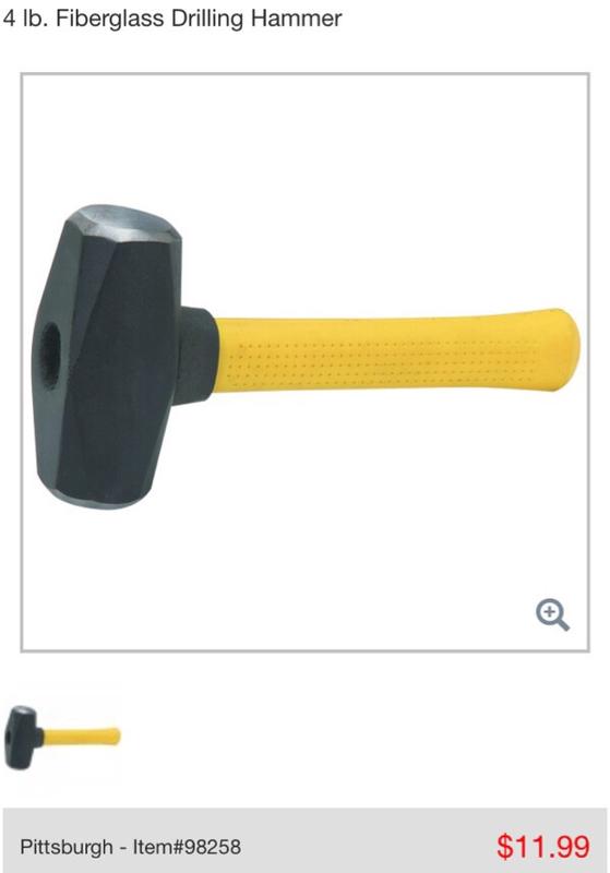

My rubber mallet is only 1 and a 1/2 pounds but Ive been banging away on the axle without much progress. I hooked up the puller but when I start to torque it, the entire hub starts to turn. If I put the wheel back on so the hub doesnt spin, theres no where to hook the puller. :( I guess I'll go back to banging on the axle in the hopes that it goes in just slightly. :(
Have to use a metal hammer, not a rubber one. You can bang on it with the metal 'mini sledge' the. Use the puller.
http://m.harborfreight.com/4-lb-drilling-hammer-98258.html
Make sure the pullers threads are coated in anti seize.
If you're spinning the hub, then lodge a crowbar between the studs and the the ground.
