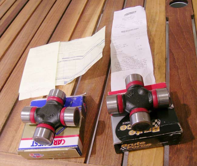

So for a few hours yesterday I was researching for a "good" 1310 series U-joint. I dug up some posts from other forums stating to skip the "Brute Force" brand (commonly from Pep Boys) and instead get the Car Quest "Gold" label.
Well anyways, I got both U-joints so I can compare them side by side and it turns out that they are the same exact U-joint.
On the left, the Car Quest U-joint. And on the right, the "Brute Force" U-joint
They even have the same exact "103" marking on the body:
The box also states they are from the same company, NEAPCO:
So whats the difference between the two? Well the price.
Car Quest: $17.48 (before tax)
Pep Boys: $14.99 (before fax)
Perhaps in the past Car Quest used a differnt manufacturer for their U-joints but the one I purchased is of course exactly the same as the one from Pep Boys.
It also should be noted that the "Brute Force" brand is available not only from Pep Boys, but also I think Advanced Auto.

The numbers like the 103 on the ones IZwack posted are casting numbers used by the maunufaturer.
It does not mean they are identical parts. The body might be the same but the caps them selves are probably a different i.d and/or o.d.
