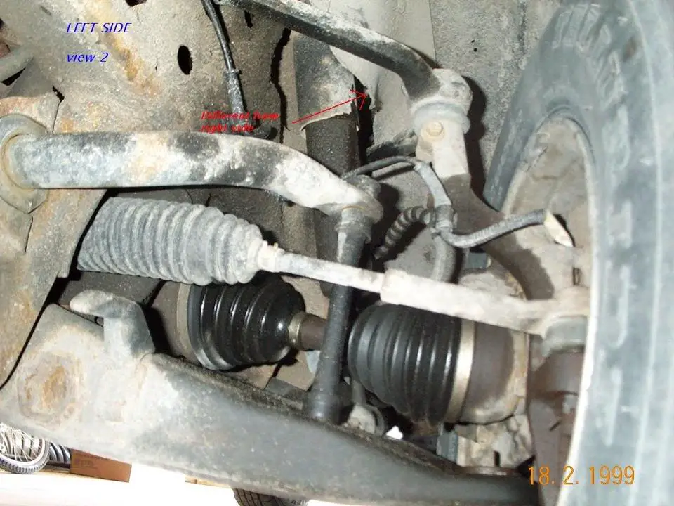

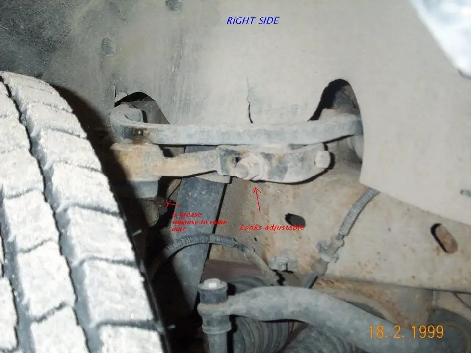

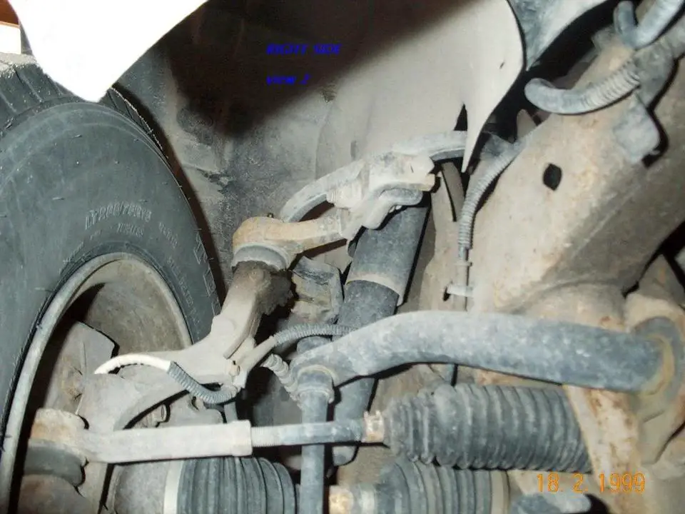

Well my explorer has always been pulling to the right since i bought it from the mechanic..
today i noticed when putting air in the tires that the upper a arm was way different from the left one..and im thinking that this may cause the truck to pull to one side..i took pictures of bother sides.
if i bring it to a aliment shop do you think they would be able to shim or adjust it so the truck would go stright..
The left & right upper a-arms are different by design. They get adjusted where they attach to the frame. There are 4 plates (2 for each side) that are used to adjust the camber. Some places call them cam adjusters. They are about $20. Stock explorers can't adjust the camber. These adjusters allow the camber to be changed.
An alignment shop should be able to put it back in to spec. Expect to pay $20 to $40 more because of the cam adjusters. You can always supply them yourself. How does the wear on the inside of the tires look? Also, the car should pull to the outside of the road because of crowning in the road.
