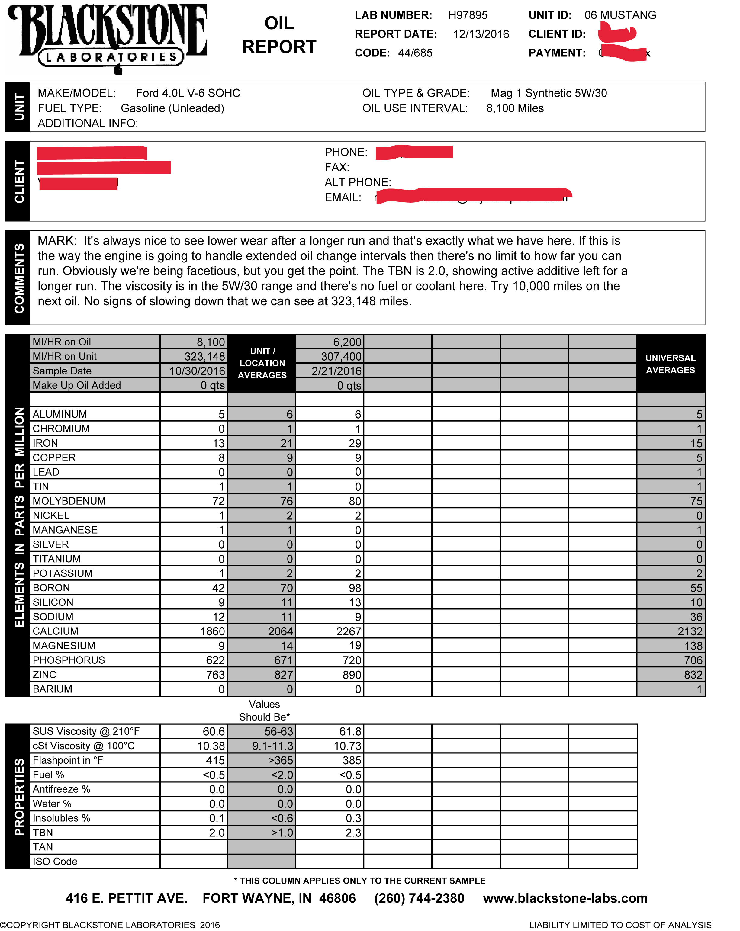

Got another UOA back. This was was pulled at 323,146 miles and was in the motor for 8,100 miles (I didn't send a sample in on the last oil change).
I'm probably going to stick with the 8k mile oil change as that's been the target for the oil changes. I start to think about it at 7k miles have it done before 9k miles.
