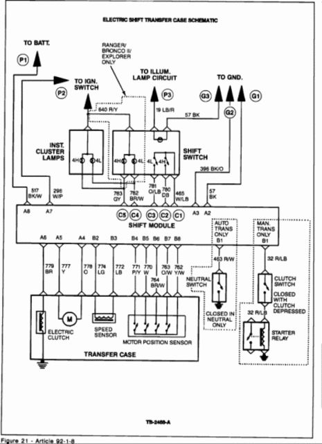

1) Does anyone have the wiring diagram for the 4x4 system?

Here is the 4x4 electrical diagram. Of course you need to think about why the previous owner cut one of the switch wires in the 1st place. Maybe a wire rubbed its insulation off and shorted out; and the quick solution was to cut the wire..
Thanks a Ton man, someone sent me this before but think it got deleted.., but this is on the newest explorer I got an the wire is not cut on this one... With the one that the wire is cut, I purchased that of my uncle an he is known for cutting wires an rigging stuff up so im sure it probaly was nothing cause i have it all hooked up on that vehicle an everything is fine.... once again thanks alot
