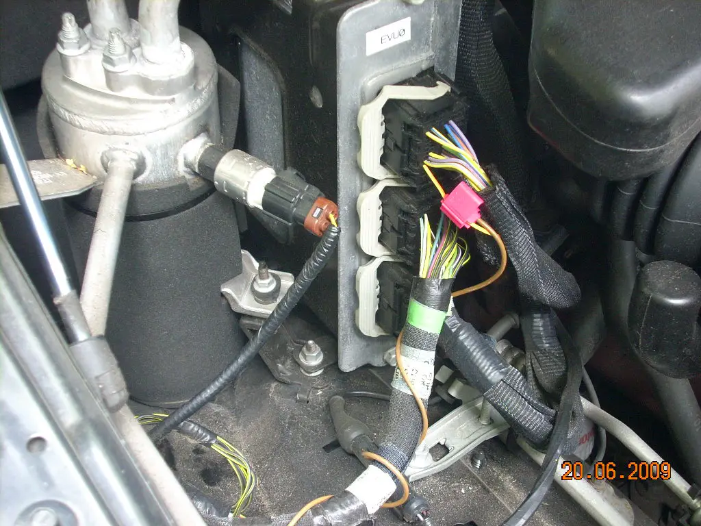

In 2009 I was also looking for a vehicle speed signal for my navigation.
At least I found it. It comes from the PCM and is for the front wipers. Should be pin #4 . It works fine until today.
Edit: The picture shows the wrong connection at pin #3 , yellow/orange, where the signal is for the Output Speed (OSS) Sensor. I remember that I first was wrong using this signal.
Pin #4 should be right: Intermediate Shaft (ISS) Sensor, grey/yellow.
