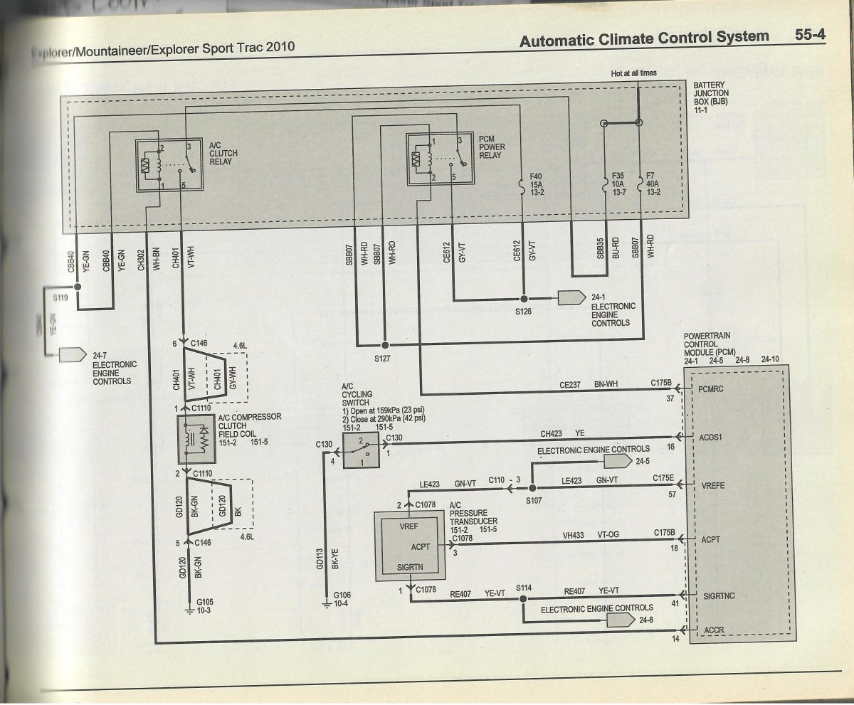

Is the ac compressor wiring in any books I can buy? Maybe the Haynes or a Chilton repair manuals?
Note C175B C175E at the PCM side are actually different connectors
