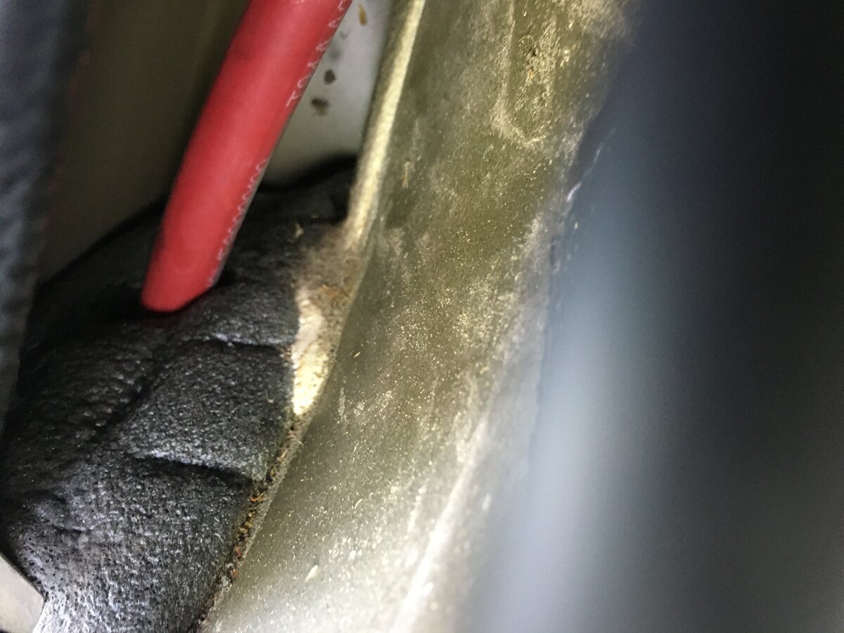

One thing that bothers me about the design of the drain system is where the hoses lead to.
The water that is drained off the sunroof is led down to the rocker panels. Water runs right into the rocker panels that are known for rusting away.
Can't our engineers come up with a better way to build a vehicle? Maybe I just expect too much, after all how many years is a vehicle supposed to last.
This picture shows how the bottom of the hose goes through some insulation and right into the rocker panel area.

Sorry I have no picture of the exits, the rear ones go inside the rocker panels so you cant see them.
That picture above with the red hose going down into black foam is the exit, but you cant see inside the rocker panel where it dumps.
I pulled the rear hoses out of the foam and blew backwards through them.
For the front I removed the hoses at the sunroof itself and blew compressed air backwards through the sunroof.
Then I blew air down into the hoses when they were disconnected.
