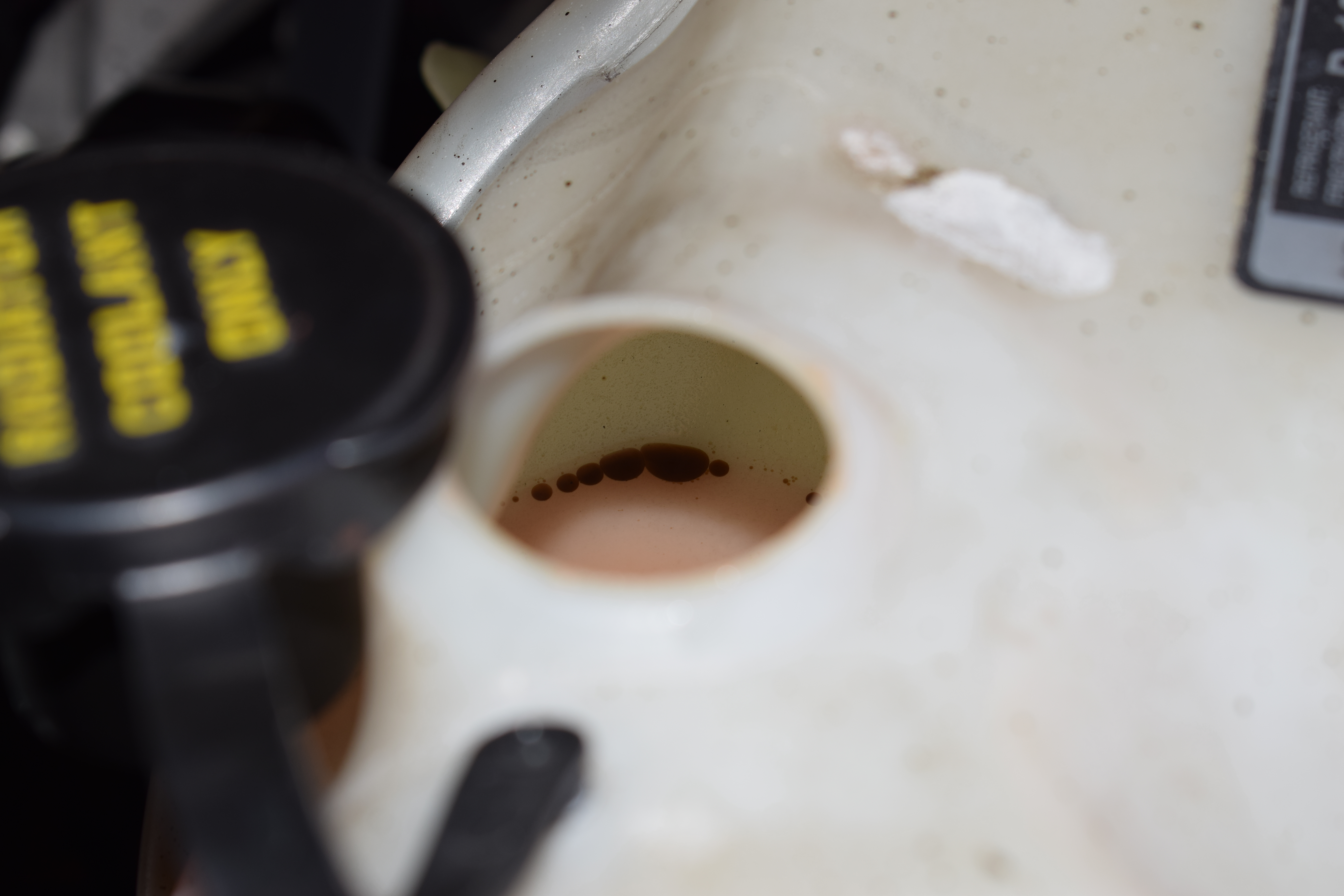

I returned from a 900 mile trip to the Valley of Fire north of Vegas last night. Engine was running fine although it looked like it was running a little hotter than normal on the 12 mile incline south of Vegas on the 15 heading home. I turned off the AC and slowed down. Today I pulled the dip stick and checked the coolant reserve tank. I found these black blobs in the coolant reserve tank. (Note: Pink coolant = Motorcraft Coolant plus Redline Water Wetter).
Engine started to develop a rhythmic gallop sound. Almost like it was missing a cylinder. It still runs fine. I think I better start saving up for a new engine. I have a feeling it's cylinder 6.
Is this fixable? Would a compression test tell me anything? I have a Harbor Freight compression test kit.
If that's oil in there, then no, can't be good.

Yikes there's oil in there and only two ways to get there. Accidentally adding it and a bad head gasket.

Yup, I did NOT put oil in there, lol!!! Matter of fact, I think I had put a 1/2 quart into the oil pan in Baker, CA, during the run back home. That's when I noticed the temp gauge was about two mm hotter than normal. This was just as I was hitting the big long incline leaving Las Vegas. X had to downshift twice placing me into 3rd, if I am correct, to clear the climb. It took about 8 minutes to traverse the incline. Once I got past the incline I knew the next two mountain passes are shorter.

Is the radiator original? Are you actually loosing oil while driving?
I just had an 08 hummer in my shop that the whole radiator was filled with transmission fluid from it leaking internally. Don't jump to the gun and replace the engine without fully diagnosing your issue.

My coolant is currently full of small fine metal shavings that look extremely clean and bright/reflective. I think it's aluminum which should point one of the heads. I completely flushed and refilled my radiator twice about a month ago.
My last Blackstone oil report stated that my iron level had jumped up. I wonder if there's some connection to those metal shavings in my coolant. Those shavings could be iron. I'll try to find the report.

Update: While I'm figuring out resources etc., I noticed the coolant in the main radiator is starting to become a bit cloudy. I can only imagine it's motor oil is the culprit. I'm looking into the radiator thing, interesting. I'm preparing to send a sample for Blackstone to tell me what's in the coolant. Compression test to be completed on Sunday. I'll post results. Is it important to perform a wet compression test?
Update: Compression was acceptable. I will get the breakdown by piston tomorrow. Drained the 0/40 oil. It was black and had a burnt odor. We sent the oil to Blackstone Labs to see if we have any coolant in the oil and get a summary of whatever they find. Mechanic said it could be the radiator. I'm not a mechanic so I don't know exactly what he's referencing. He also wants me to send a coolant sample to Blackstone to confirm tranny fluid is or isn't what's in the coolant.
