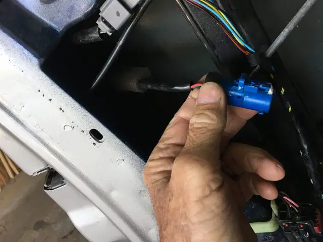

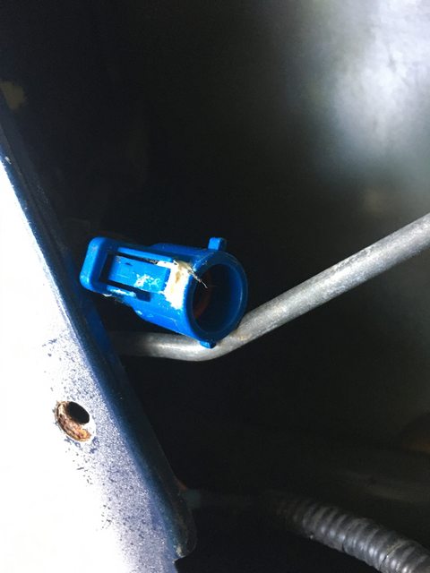

What the hell is this round blue plug go to that was in the door, up near the top/rear of the door?
I can't find anywhere it would go to. Is it extra?
No one has seen this plug before?
No one has seen this plug before? What's it's for? TIA
If you watch that video you attached (at 10:55 in the video) you will see that connector. It is a junction that runs to the door latch switch. It may be where the keyless entry push button control ties in to the circuit (I am not sure).
Thank you! I see it now!
Too Bad it's already back together! Quick fix if I need to hook it back up- I'm going out to check it now! The keyless entry was working before.

* UPDATE*
Funny, I didn't take the blue plug off when I was getting into the door!
Everything still works! The Key Fob, The keyless entry, etc.
** I figured out what it does!
It locks all, or unlocks all when you manually put the key in the door! That's it.
Not worth going back in for that.
