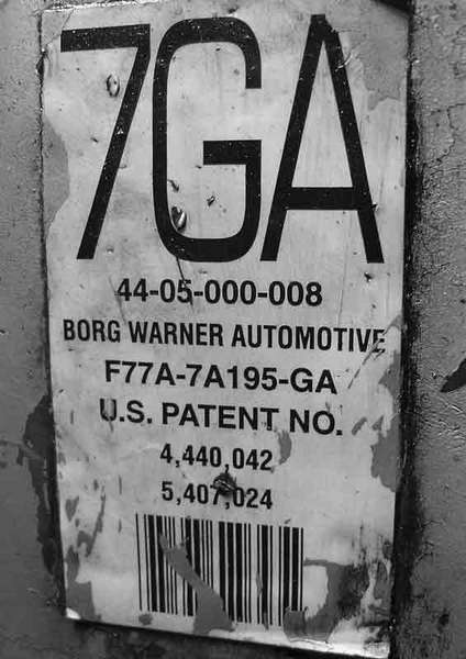

I dunno either but its not the GA since this GA was on a '97 Edie Bauer.

Ok, so I got down to look at the T-Case. I got the number off of it and got a surprise. Its a F77A 74195 GA. I think that the 4 is supposed to be an A. So thats weird. I am going to go check it again. And its a 96 XLT V6. I checked the VIN.
OK, so its an A. It matches that number on the tag you posted. But It is a 96. So thats weird. I have to find a 96 GA.
