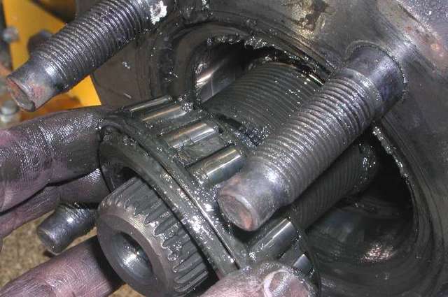

well i got around to tearing the front end down to day and found this...
if you can see it,terns out all it was is the last owner did not reasembel the locking nuts and washers. thay apear to have came off some
