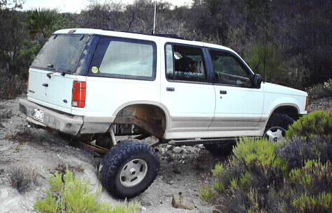

I believe Jerry had them custom made or he made them himself. I asked him about it when we were at Truckhaven. I was thinking about seeing if Rock-Sliders would perhaps make a limited quantity for 4dr Explorers. Would you be interested?

Hey Jon, I don't really think that the ones in that picture are used as steps, but to protect the rocker panels from getting damaged. The ones you are thinking about (at least what I think you are thiking about) are usully only good as steps and get in the way off-road. since they are 3" tubing and they sit about an inch away from the body I supposes, then that would give you around 4" less clearance off road with the tube steps.

Hey Jon, here are some pics of one of the featured explorers on this site, they don't really show the nerfs that well, but you can kinda get the point of what to get.
I think rick has some, but I forgot where I saw a pic of them. You could go to a 4x4 shop in your area and they , more than likely, will be able to make you some. I have some jeep catalogs that have great pics of them, but I don't have a scanner. Also, the local 4x4 shop around me has a website and they did have a good pic of them, but they changed their website and they don't have that pic on there any more, I will try to e-mail them and see if I can get that picture.
Ok, went searching and found this one of ricks:

Our nerf bars are custom made. We have 3 cross members, one in front, one in the middle, and one in the rear. When they built ours they tried lifting the truck with a hi-lift jack by the nerf bars. The bars flexed so they put in the center cross member. Of course, they know my husband! Dead Link Removed Anyway, good luck and hope this helps.

I made the bars out of 3/16" 2"x4" sQ tubing, with a 3/16" runner of 2"x2" angle iron bolted through the body seam into the 2x4 bar. Also there are 2 stringers from the bars to the frame. As for using them as steps, I do, but my wife has a real problem getting in, the bars don't stand out far enough for her to use. I have some pics if you did to see them send you e-mail to offroad@cari.net
