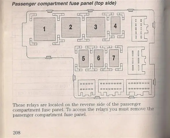

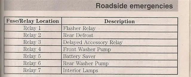

According to my owner's manual for my '02 XLT, it's behind the fuse panel in the passenger compartment.
If you don't have an owner's manual, Dead Link Removed.
Hope this helps out!
Ya now good luck getting it out. I tried to get mine out to put one in for LED signals and couldn't get to it. I am sure I was doing something wrong but not sure what.
