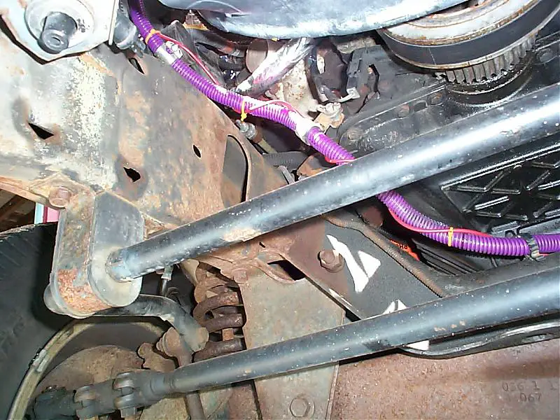

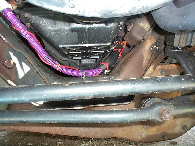

dont want to sound like a ass but if he has trouble finding the starter a battery cable replacement may be too much for him. that being said here is how i ran my new cable 56'' or so of # 2 battery wire
