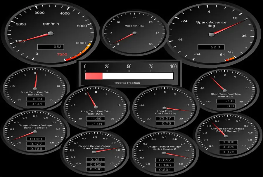

Here are a couple screen shots from my laptop.

Wow Bob. Was that screen shot from your 98. That is one of the most user friendly displays I"ve ever seen. Does your scanner access transmission or ABS codes. Must be pricey if it does.
The basic ScanXL software is $99.95 plus the Ford enhanced package for $99.95. Software and OBD interface was under $250. That top graphic screen I made with the software to check out my O2 Sensors. Its built into the software they call it DashXL. I made a few different Dash displays for my Ford, not the most user friendly thing in the world, but not the worst.
