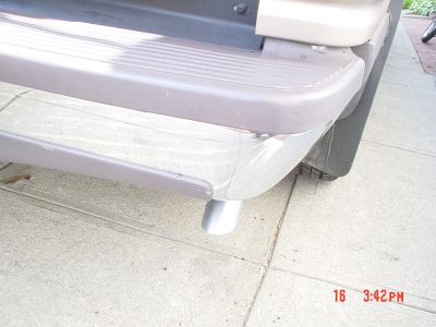

I'd like to modify my stock rear bumper a bit. I've been staring at it a lot lately and the more I stare the more I'm convinced that it's just ugly! It sticks out way too much for my liking.
So, what is the right tool to cut this thing to size?
Thanks. :)
