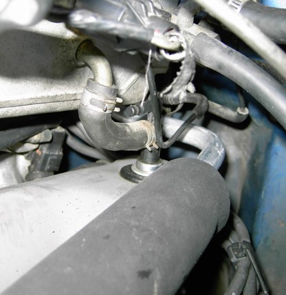

Hissing sound may be a vacuum hose came off the tree on the rear of the back of the driver side valve cover. Loss of vacuum causes surging and other odd problems.
Never heard it to be associated with white smoke though - steam?. Was the exhaust manifold hot? Could be a blown automatic transmission modulator vacuum line spraying auto transmission fluid on a hot manifold. Or a PCV valve vacuum hose.
Any smells? Beware a gasoline smell, it may mean injector fuel rail problems.
I wouldn't drive until you trace the source of the smoke. Should be fairly obvious.

Hey the hose in the bottom pic on the back left what does that go to?
The FPR and the A/C Bi Metal may be reversed. it doesn't matter.
Keep in mind, mine's a 91 4WD
