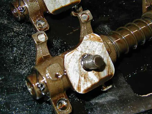

Have the rocker arms ever been replaced?
The stock rocker arms were made of softer metal than they should have been, so they get indentations where they contact the valves. The pushrods also wear where they contact the lifters due to poor oiling.
This kind of wear will give valve clatter that is light at first and similar to engine ping, but will eventually be loud, full blown valve clatter at 2-3K RPM under load.
That and lifters that are slowly getting "stuck" in the lower position can cause noise they worse they get.

I might have to look into the rockers. But this is so intermittant. Sometimes barely there, other times unignorable. It seems to worsen in warmer weather. Around here, we have BP as a brand name for gas, and little else.
Fuel injectors were a thought. Would a bad oxygen sensor do it? I'm just picking things off a list at this point.
The clatter from worn rockers is still intermittent - they can be serverely worn down and still quiet when driving around but clatter super loud under load, say when hitting the gas accelerating up a hill or when the cruise control surges to maintain speed on the highway.

Ahh, therein lies the issue. I kinda feel as if the rockers might not be too bad, as when the head gasket popped, zero noise. What tipped me off was the climbing temp gauge. I just have to track down what the issue is.
