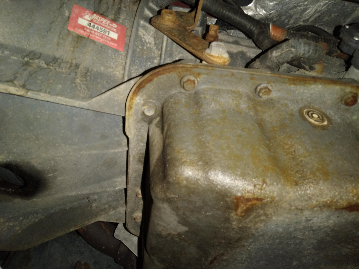

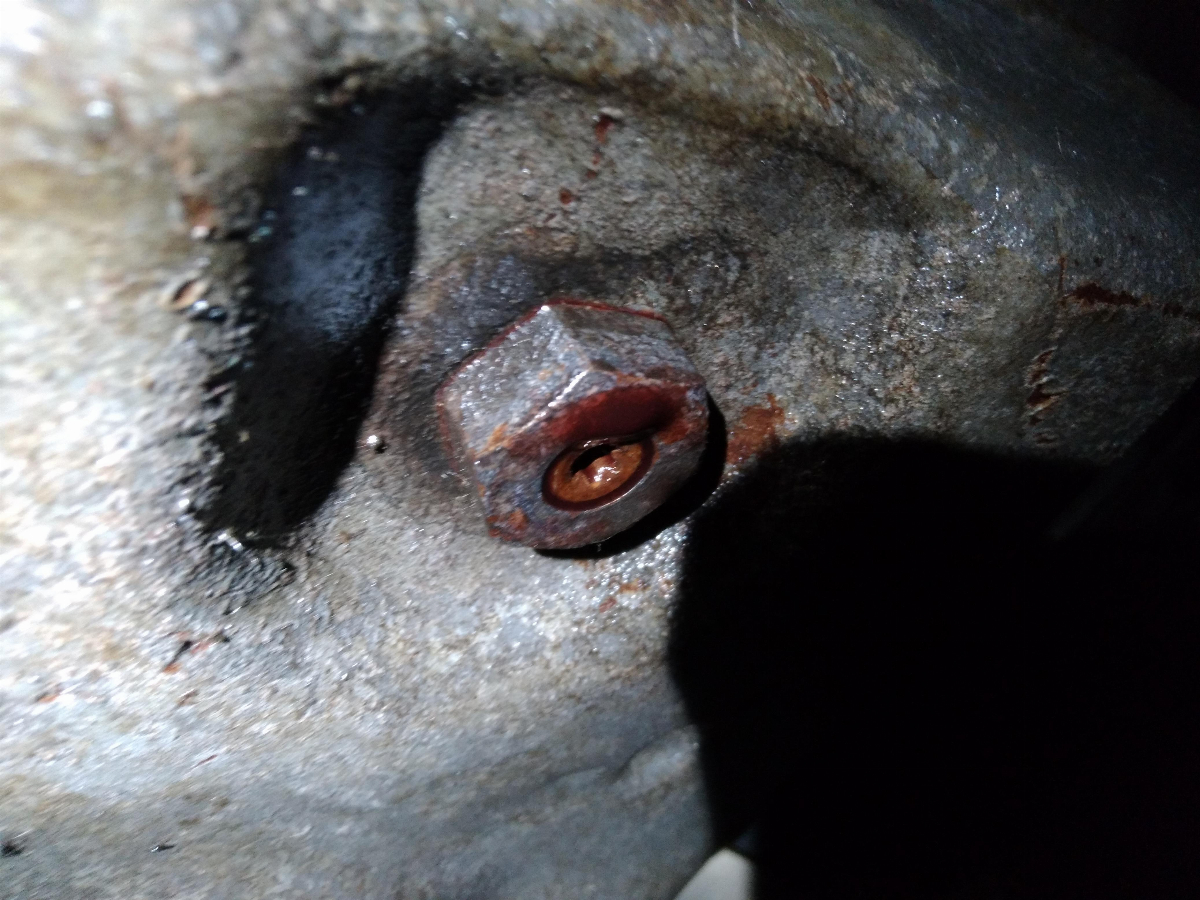

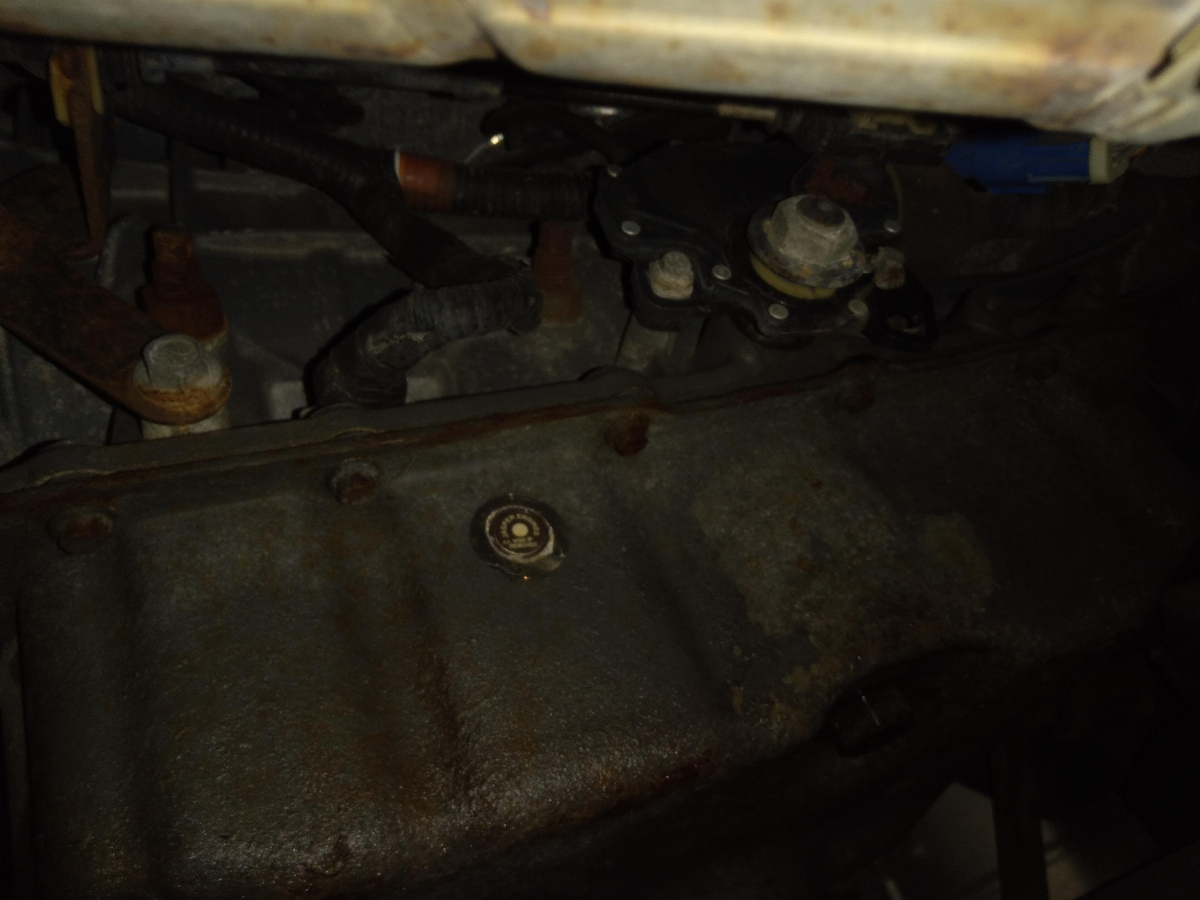

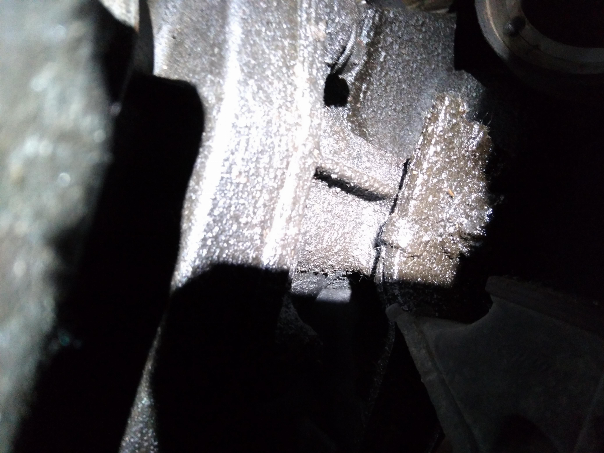

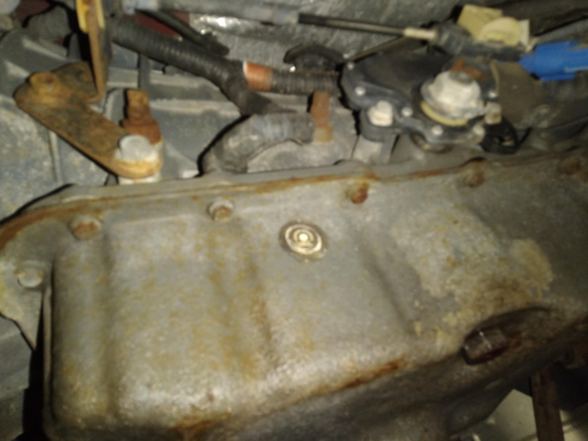

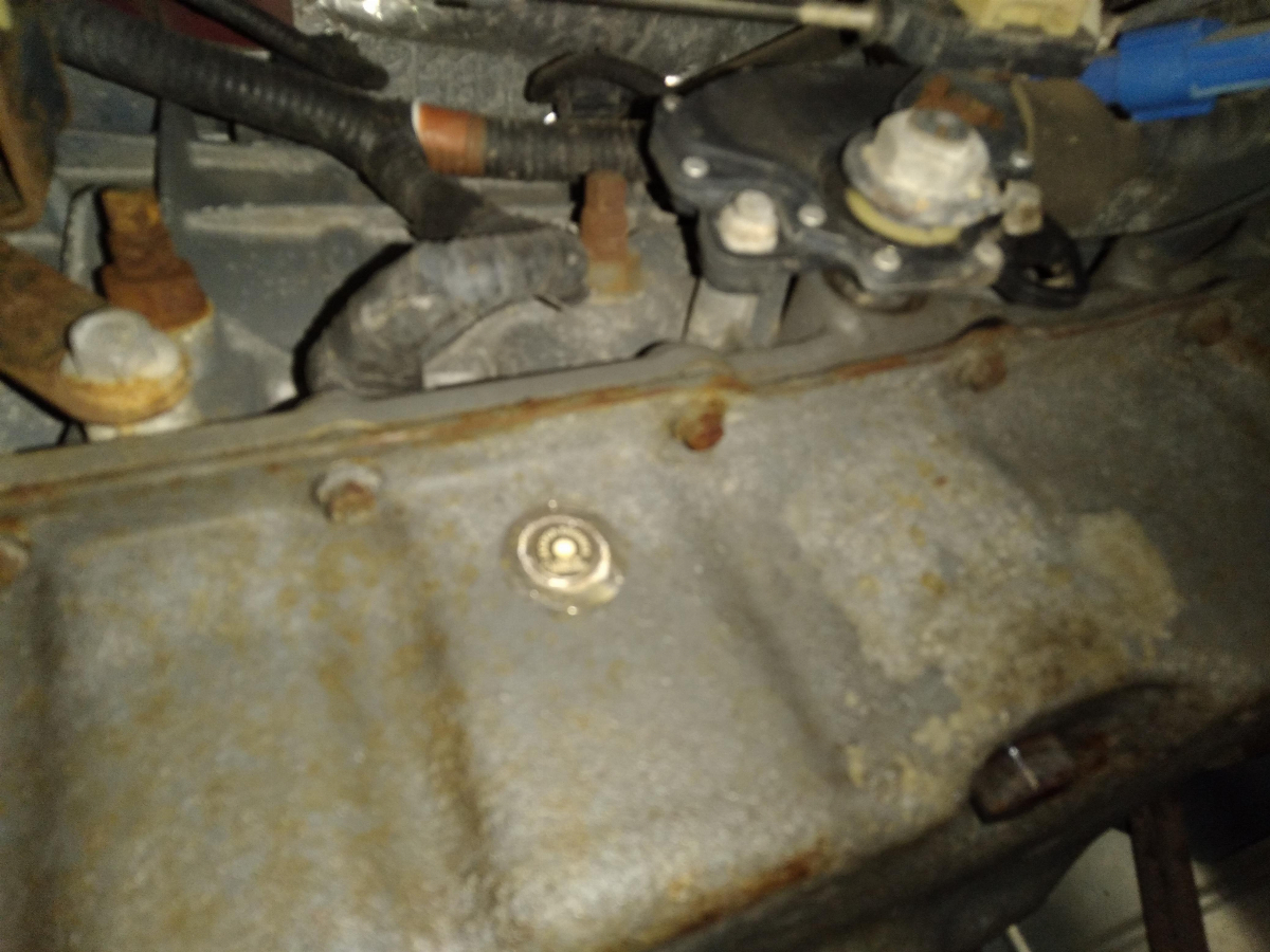

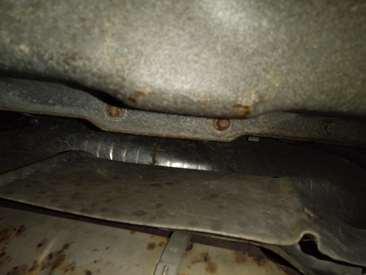

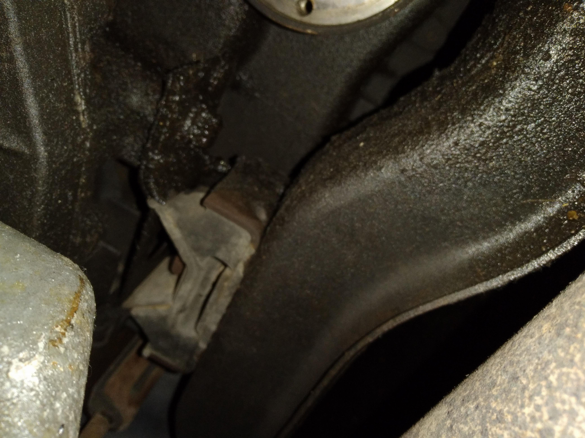

Ok. Let me try and take some pictures of some reddish wet spots. I am not great at diagnosing leaks myself; maybe with some help.
From these pictures, there is not any obvious leak
from the pan gasket (that I can tell). There may be a leak
from the pan-plug itself; although since the plug is the lowest
spot, I suppose that could be a wrong conclusion...
I notice there is a lot of wetness where the transmission meets the transfer-case. I have never had
to add transfer-case fluid (and that is very easy to check with my pinkie on a cold engine). However,
maybe one of the seals between the transmission and t-case is bad and is causing a transmission
fluid leak ? (That would be at least $425 after fluids and ubers, to get those seals replaced.)
