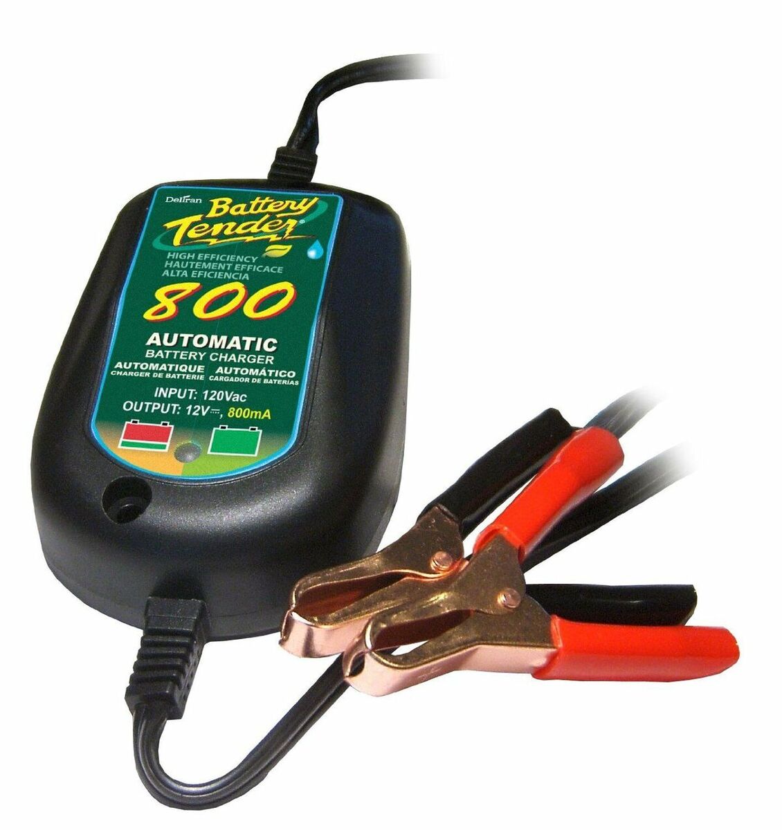

My 2001 5.0L EB sometimes sits garaged for months between starts. I find after a couple of months the battery is very low (fairly new battery). It will still start the engine, but it struggles a little, so there's enough of a drain to be concerned about if you don't use your vehicle on a regular basis, especially if it's sitting outside in winter.
If you have power near where you leave your Expl, get a Deltran maintenance battery tender to keep if fully charged (around $40 on eBay). It's water proof and it will keep your battery charged w/out over-charging it.
