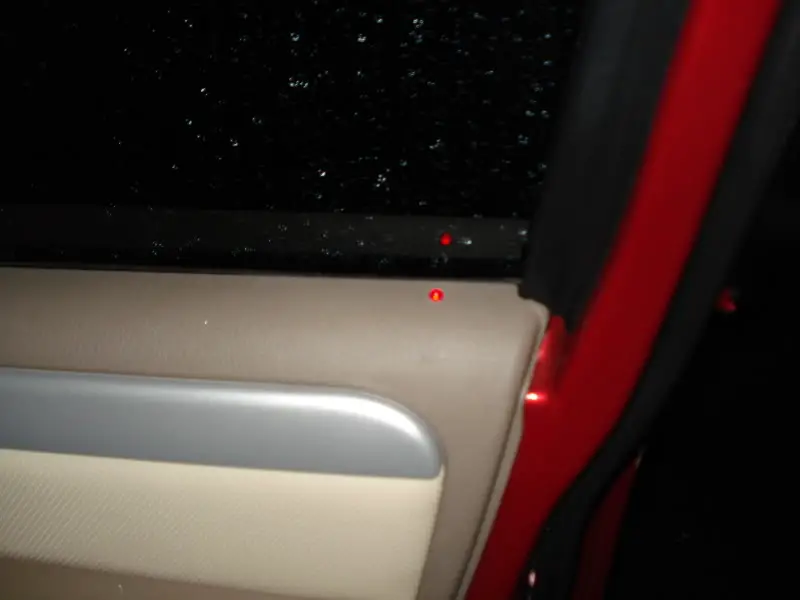

I have added a security warning led mounted in each front door sill, and spliced those into the OEM theft light circuit. They look sweet and blink with the dash light.
