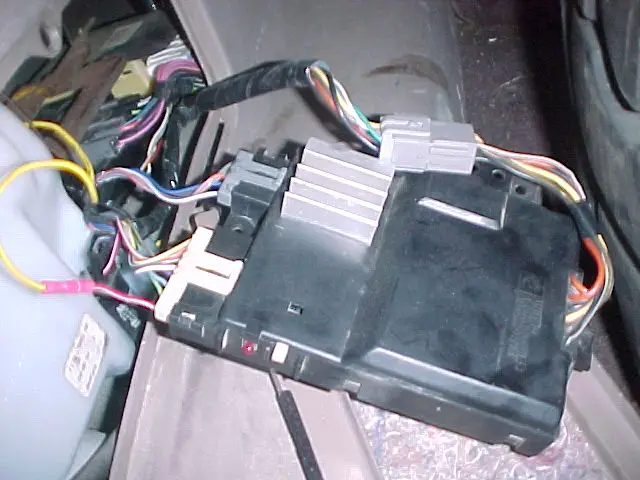

Third Question: I have read about the factory remote locks/alarm having a seperate black box with a white sensitivity button on it. Is this factored into the system, because it doesnt have a sensitivity nob, etc, but its a small black box. If not what is it for?

The control module in the first pick has nothing to do w/ power locks or alarm. It's the push button 4x4 control module.
?????? The black box next to the rear winshield washer resivoir, with the 3 conectors???
Yes this is the 4x4 computer
You can see the Yellow wire that I grounded so I can shift into 4-low with out being in neutral or stepping on the brake.
