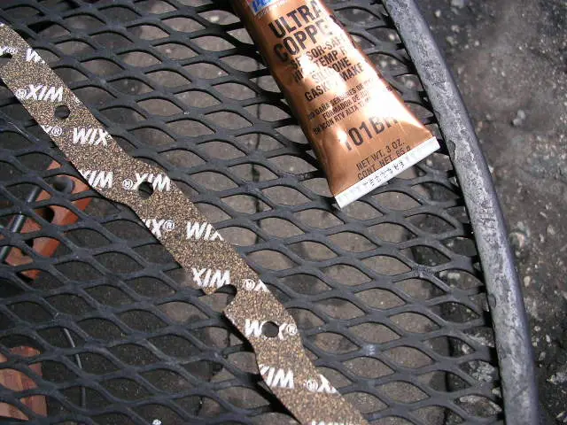

so after buying a wix brand filter i'm wondering if the gasket they supplied is better than the rubber ones i've used in the past ....pic ,
looks like the gasket is a hybred of rubber and cork !? will this be ok or should i go buy a quailty rubber one ?
I've always used the gaskets that came with the WIX filters.
I don't use any sealer, either. I just use them dry.

Never use gasket maker in a transmission as it has the potential to break off and plug some of the small ports in the valve body.
never really thought about that ...good point . ( btw when i got my x the person that did it the last time just used blue rtv ...no gasket ! )
i've used that in the past for pans and i useally put it on thin and press the gasket to the pan the the tranmission side of the pan i leave clean .
i do have this ....
the only reason i put this on is to hold the gasket in place and provide a little extra umph' for sealing .
so your saying i really should not use anything ?
I have never and would never use gasket maker on any transmission I repair. Usually you can place the gasket on the pan then push the bolts through both the pan and gasket. The gasket will hold the bolts in place, then when you are installing the pan all the bolts are already there. Just screw the 4 corners in enough to not push the remaining bolts out of the pan. Get them all secure then tighten them to required torque. (I don't use a torque wrench, but it is possible over tightening will cause a leak) I usually use rubber gaskets but I know this works for some cork gaskets. But after all that being said, its your vehicle you can do what ever makes you happy.
No, don't use any sealer on the gasket.
The bolt holes in the gasket are slightly undersized, so they will hold the bolts in the cover, making it much easier to line up the gasket when you re-install it.
BTW, are you going to put in a drain plug? It will make future changes significantly easier if you do.

and i understand about the sealant ..... i'll just use the gasket by it's self . ( thanks for the info on that )
