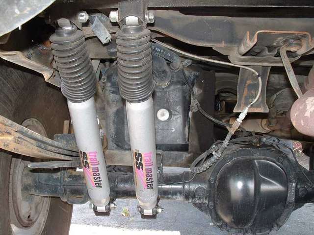

So installing the rear shocks like this will more flexibility in using these shocks?
This install looked rather simple in locating a bar atop the frame rearward.
What would I be looking for as to an angle or distance from the axle back?
