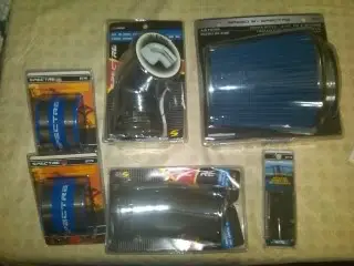

I hope that this will get stickied for future reference, for 04-05 V6 owners...
http://www.powerflowracing.com/forum/topic.asp?TOPIC_ID=1227
so i was on google, and stumbled across the link above. with help from the link, and a little of my own searching. I have made a complete list of required parts to finally have an " INTAKE KIT " available for our application for roughly 150 $ ( quoted price directly from spectre ) actual costs may vary. I know its not a K&N Intake, but its better than nothing...
prices are direct from spectre - just making that clear...
" Kit Parts "
1. PN - 8776 ( x2 ), couplers, 18$
2. PN - 8698, 90 degree 3'' elbow, 15$
3. PN - 8728, 22 degree 3'' elbow, 14$
4. PN - 9405, mafs adapter, 36$
5. PN - 9713, vaccum fittings, 5$
6. PN - 8136, cone filter, 32$
7. PN - 8130, heat shield, 38$ - ( Optional, but suggested )
* Thermo Wrap for the intake will help reduce some heat soak, but is optional
Hope this helps fella's !

honestly excapt for there silicone couplers I would skip it, you can get pretty good size pipe in mandrel bend and mock just about anything up, its hard because we are MAF but you can cut thatr housing off the air box.
don;t try a 4 inch maf housing it doesn;t work without tuning. I do use specter stuff peice mill but normally do everything inbetween myself.

The spectre one is crap. Look at the filter, its just sitting there in the engine compartment. Engine compartment temps get much higher than the incoming "cool" air. Without a divider that helps to keep the warmer compartment air "out " then your just polishing a turd. However, the K&N setup shown above is a much better filter setup. It clearly shows a divider, this helps to separate the warmer air from the cooler air, giving you a more true cool air intake.

started making progress towards getting an intake system complete...
i just need to order the MAF housing, since Pepboys and AutoZone didnt have the correct part i needed...
now my major concern, is just making a hole for the vaccum line...
