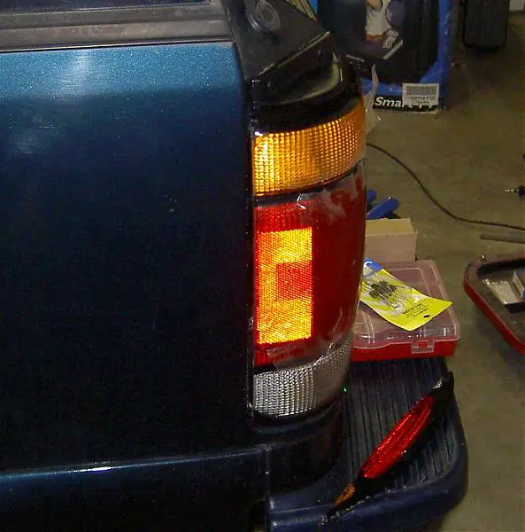

Hello, I have a 93 Limited body, which is about to be set down onto a 99 Limited chassis.
Has anyone ever fitted the later 95+ tail lights onto the 1st generation Explorers? I have already discovered that there are three bulbs in the later lights, and the 1st gen body lights have straight side and rear edges.
From what searching I have done, the rear of the 95-97 tail lights look like they will fit against my 93 tailgate. Will the lights actually bolt down using the same bolt pattern? They look the same.
I am assuming that my task will be to trim the side front edges of the 95-97 lights until they are straight. Then I'll have to fill the holes made, and paint a small black strip along that edge.
Ideas, thoughts about this, anyone.

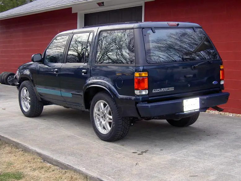

Well you have a long memory. I did get them almost done last year, and began driving the truck in January. They worked great, I have just not yet painted the front 1/4" edge black yet. The front edge there still shows the epoxy work done to it. I like the amber turn signals better for safety, that was my whole reason to do it. Regards,

Well that picture showing the piece which is cut off tells most of the story. Cutting it carefully without cracking the lens is important, go very slow with a rotary tool. A lot of filing is needed to sneak up on the correct sizing, go very slow and gently.
Then it's a matter of a few tubes of epoxy(Walmart $3.80 per). Use clear tape to create a backing for the epoxy, mix only about 1/4 or 1/5 of the tubes at a time. Only do say an inch or two at a time. I ended up with about a 1/8 to 1/4 thick layer along the front edge. You fill the gap and then layer it just above the needed outer surface. Then it comes down to more filing to shape it well, then tape it off to paint. I plan on using black model aircraft spray paint. If something is better and will last longer, let me know. Regards,

how are these doing ? epoxy holding up ? not filling full of water or anything like that ?
They work great. I do have white strobe lights in the reverse lens portions, and those melted a hole through the back. I've had one fill with water from it getting to that backside hole. I plan to find some kind of metal material to cover that hole up.
