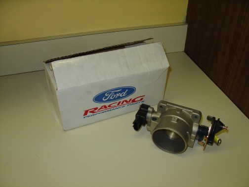

I decided to change the throttle body on my 4.0 SOHC Explorer. The idea was conceived earlier this year when I was in Birmingham, AL, doing some dyno work with Doug Studdard ( http://www.bamachips.com/ ) and meet James Henson ( jah81592 ), the owner of the STS Turbo Explorer ( http://www.explorerforum.com/forums/showthread.php?t=136871&page=1&pp=20 ). He had a larger throttle body on his truck. And that got me thinking.
The throttle body in question is from Ford Racing and made for a 1996-2001 4.6l 2V V8 Mustang.
I ordered the throttle body from Summit Racing ( Dead Link Removed ). The Summit part number is FMS-M-9926-D462 and the price was $198.83 to my door. The Ford number is F6PU-AA.
This Ford Racing Mustang Hi Flow throttle body diameter is 70mm whereas the stock Explorer throttle body diameter is, I think, 65mm.

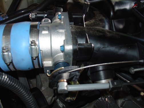

The first step in replacing the throttle body is to take off the intake cover and then remove the Mac intake tube from the throttle body and MAF. This is followed by disconnecting the TPS ( throttle position sensor ) connector. The accelerator and cruise control cables are then detached. The 4 bolts/screws that attach the throttle body to the intake manifold are removed ( the ¼” air ratchet was very helpful ). The throttle body and gasket are now removed.
The new throttle body is installed by reversing the removal protocol. A new gasket was used in this installation.
The installation took about 15 minutes.
After the installation of the throttle body, the truck was started and the throttle tested; thankfully, all was well. The idle was smooth. A brief road test showed all was well. Could I tell a difference in performance? Probably not. Gas mileage and dyno numbers will tell the tale.
A trip to the dyno as well as a long road trip is scheduled. RWHP and mileage data are forthcoming.

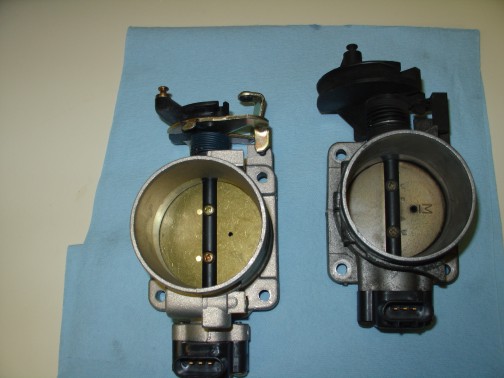

Stock ( on right ) and Ford Racing TB ......
Is there any size difference at all? From quick measurements with pshop, they look within a 1/16" of each other.
edit: nvm.............I can see it now

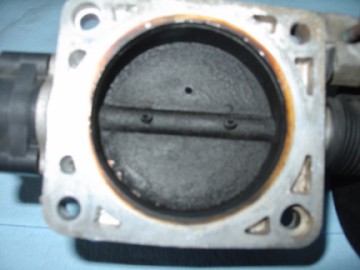

Can you please post a photo of the bolt circle.
I'm wondering if 4.0s could use 5.0 TB's, there are 65mm stock.
This is a pic of the bolt pattern ( of the stock TB ). It is identical to the Ford Racing model.

Why not just get a BBK? They're the same price. Or was this for the purpose of experimentation (Which I have a hunch that it was)?
Hello guys.... One day as I was telling al at the dyno in Bham, I was walking through my shop and was looking at an extra 70mm t\b from a 96-04 mustang gt and said damn that looks like mine. So I pulled it off and voila there it was exact bolt spacing and the same throttle position sensor,wow a direct bolt on.The only thing you have to mod if you keep it is the factory "Comb looking gasket" I opened mine up. But it appears as if Al has remove his and used the paper gasket that came with the throttle body itself. If I run across any thing else for a Stang that works on a Explorer I'll let you guys know. I have stang parts running out my ears.
Strange things happen at a dyno in Alabama ..... :)
Yes, long ago I removed the comb looking gasjet.
James, keep the ideas comming, I love to steal them ....
