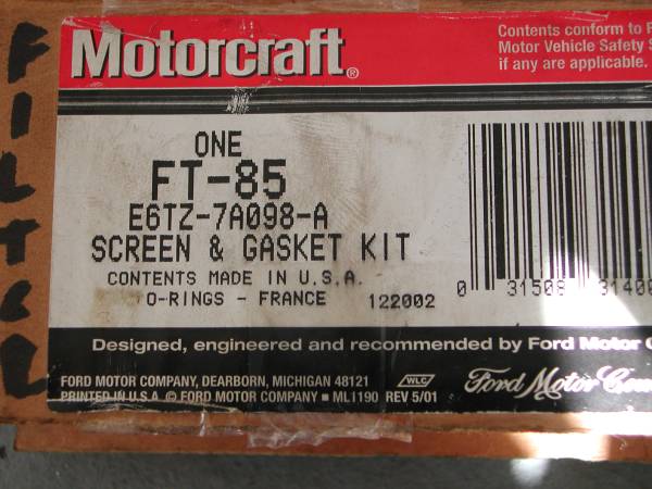

I post this as my LAST thread on filters for the A4LD and 5R55. FRAM Micro felt. I repeat... FRAM Microfelt. If you can buy Fram transmission filters that is what you will be getting. It is simply the best out there in my opinion. Now I know we rag on FORD from time to time, but what do THEY use? Here is their box:
And here is the filter:
SPX bought FRAM a couple years back.... and...MICROFELT!! Getting a hint? If you can buy a FRAM transmission filter you will be getting the same one FORD sells, for more. Buy FRAM. Please. Ok ..for those asking why, Purolater filters are a screen! A friggin screen! FRAM is a fibrous material, filter material. We can debate FRAM oil filters til the cows come home but these are transmission filters! Simply put, FRAM is the best for these transmissions. End of story. End of rant.
