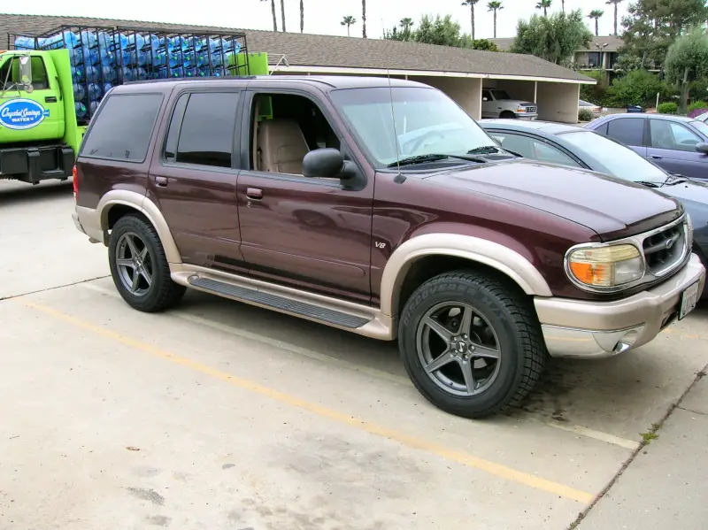

Just got my new wheels installed. They are the Saleen Mustang style wheel.
The wheel is 18x9 with +24 offset.
I had to have a 1/4" spacer installed on the fronts to clear the dustcap on the hub, and allow me to keep the centercap in the wheel.
Tires are Cooper Discoverer H/T Plus in a 265/60/18 size. It's an "S" speed rated tire, so I can't exceed 112, but the electronic governor stops me before that.
Once I lower it, I'll probably go with a 255/55/18 Kumho STX, a "V" speed rated directional treaded tire. But for now, I'm quite happy. :-)
UPDATE 8/20/06: The 265/60/18's do rub on the sway bar when at full lock, but it's very minor.
sinisterX by qwikrex, on Flickr

looks surprisingly good.

looks real good... i like it

Thanks guys. I found that not many people were running an 18" wheel, so it was sorta tough to get experience on tire sizes.
Thus far, with the stock suspension, and that tire size, I have NO rubbing, and the 265 looks plenty wide on that wheel.
I'm tempted to try a 285 next time around, but I'm afraid it'll start rubbing.

Looks good

I like those wheels.
Looks good

looks very good, i like it

very nice looks extremely good

I like the way that your tire and rim combo work with the colors of your truck.
