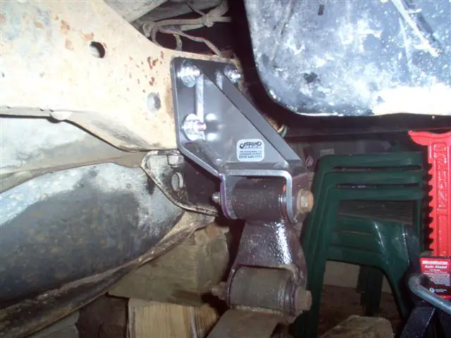

Center hole to center hole 4.5" However the top mount is differnet than the explorer. To use them you would have to redo your frame mount on the front end. Look for YJ shackes they come in a bunch of different lengths. 4"-7" can be found pretty easy. I have some extra ones that I belive are 5.75" center hole to center hole. If you want them all they will cost is ride up to chico in a box. Look at the shackles I used they are the same ones I am running up front. I just have an extra pair.
