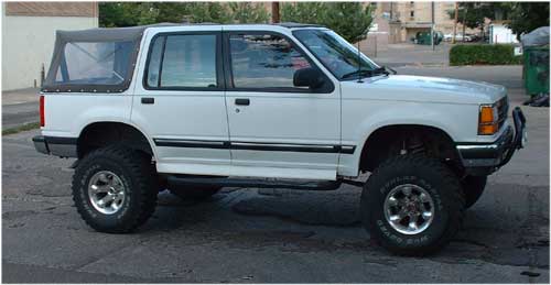

How much tube do you think the explorers will take? The Rangers would go quick, but the Explorer will take a little more time. I'm already got the OK to get me a winch, but I think I'd rather have a cage if I can do it for about the same. can't have both though:( Try to get a place this year, so really try'n to focus on that and keep the money going into the truck this year. Jefe and Matt I'm sure you can both relate:(

Here you go 4 doors.
